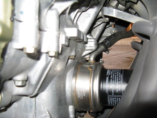

ill see if i can find you a pic. on my 1000 there is one almost directly above the draim plug, on the block, not the oil pan.
this is a F4 but you can see the lil tabs sticking out, you get the idea.
one look at them and you'll know that theyre clearly not gonna affect anything if you drill em.
If you have to think twice about it, youre looking at the wrong thing...

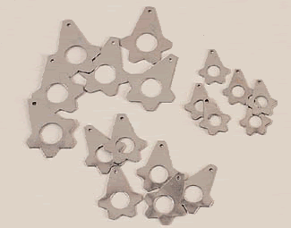

I bought some safety wire discs that give you points to wire to. You just pull a bolt out, slip this thin metal washer on it and then reinstall. It has a small tab sticking out that you can wire to. Gonna me at Road Atlanta next Friday? I've got a bunch of these.
^ id like to see these, how do they stop the bolt from backing out.
Sounds like its just a washer, edumacate me please?
The washers he's talking about are probably these, you put it under the bolt and then bend the tabs up around the head and the safety wiregoes through the hole in the larger tab. I bought some but have not had a chance to use them yet.
